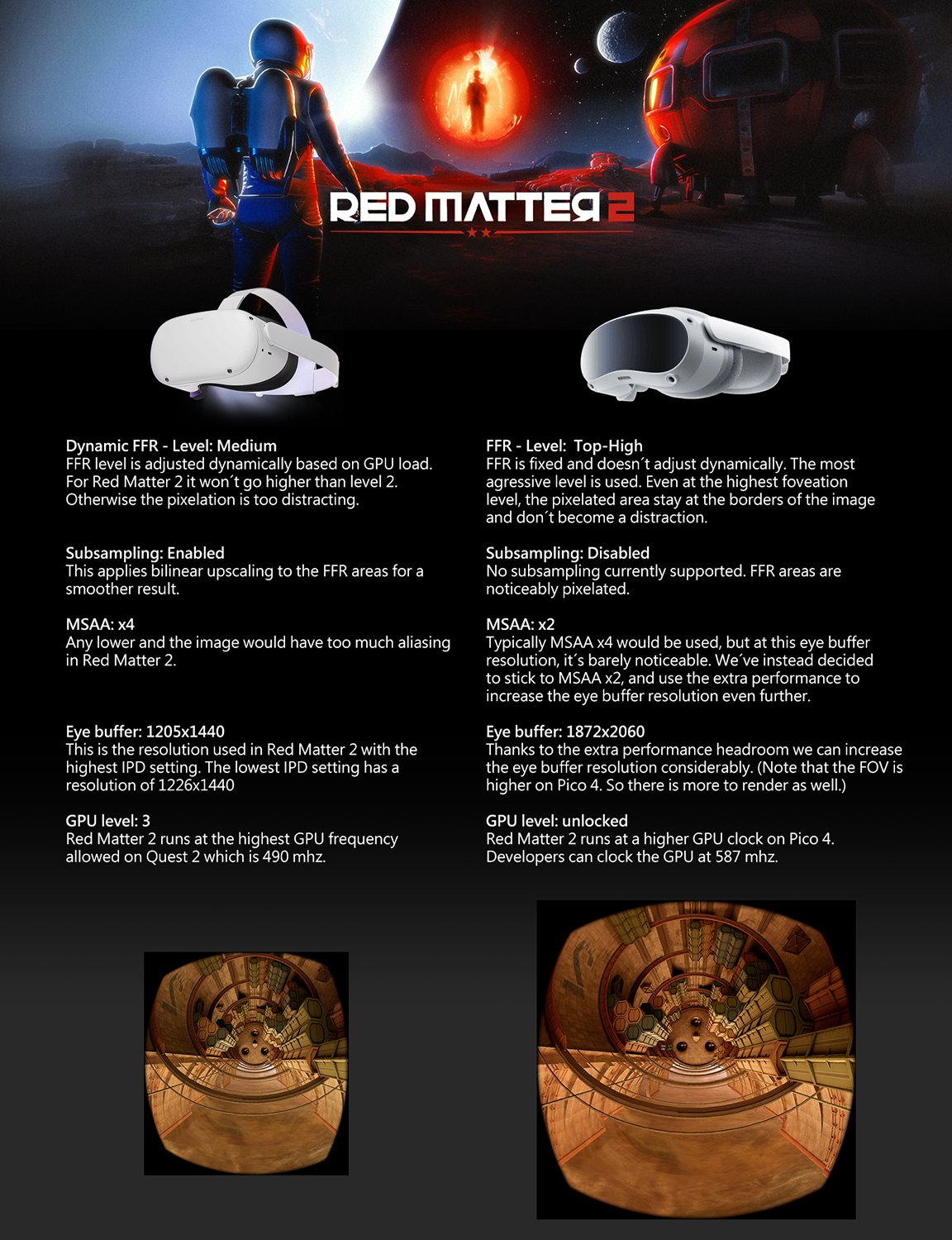

  7. Ein Tweet von den Red Matter Machern im Bezug auf die Leistung der Pico 4 im Vergleich zur Quest 2.
    "Red Matter 2 is coming to @PICOXR very soon! Here's a quick breakdown of some of the technical differences between the Quest 2 and Pico 4 versions. We have been really impressed with what Pico 4 is capable of. We can't wait for you to check out what we have achieved! #VR #PICO4"
